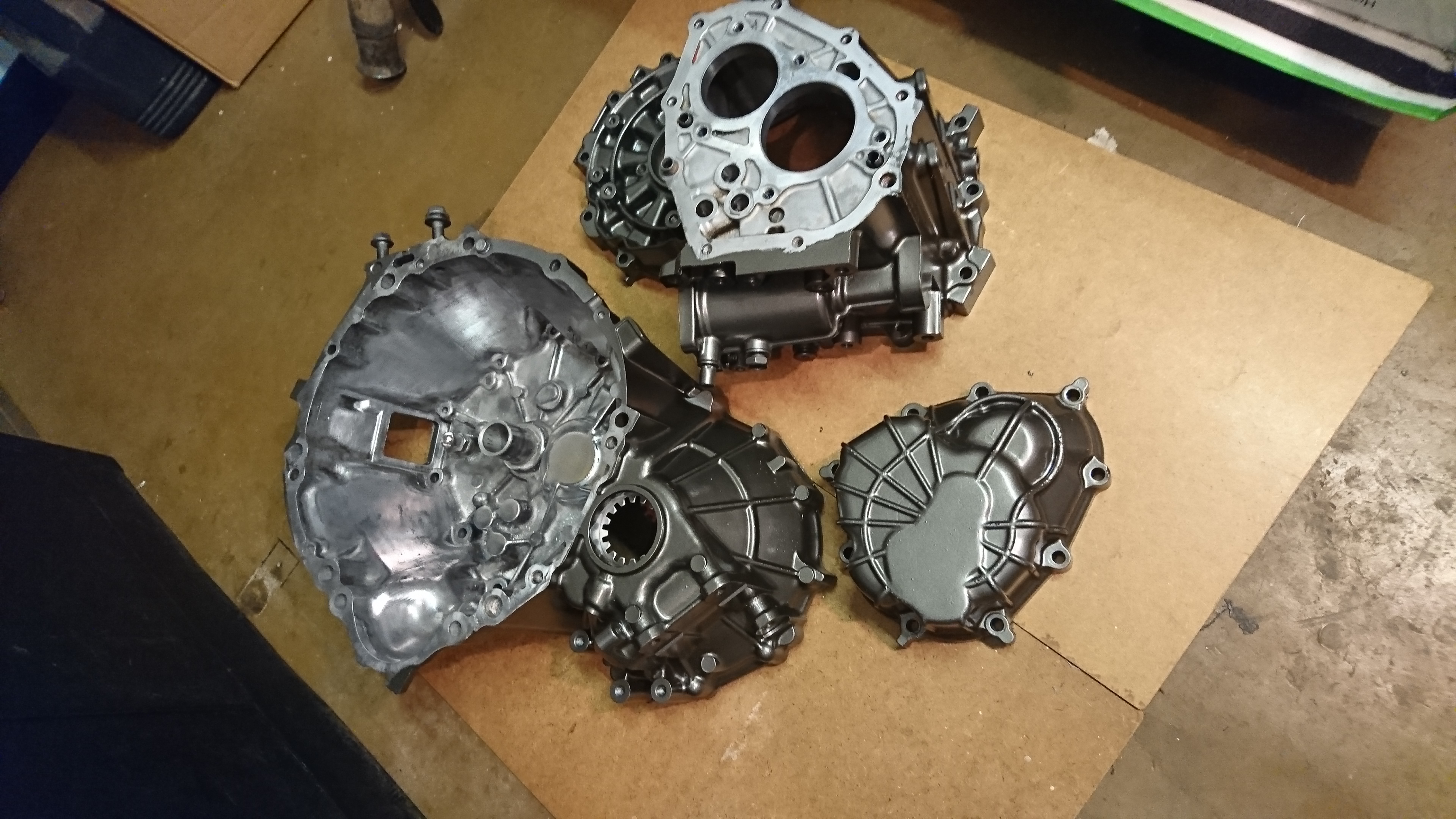

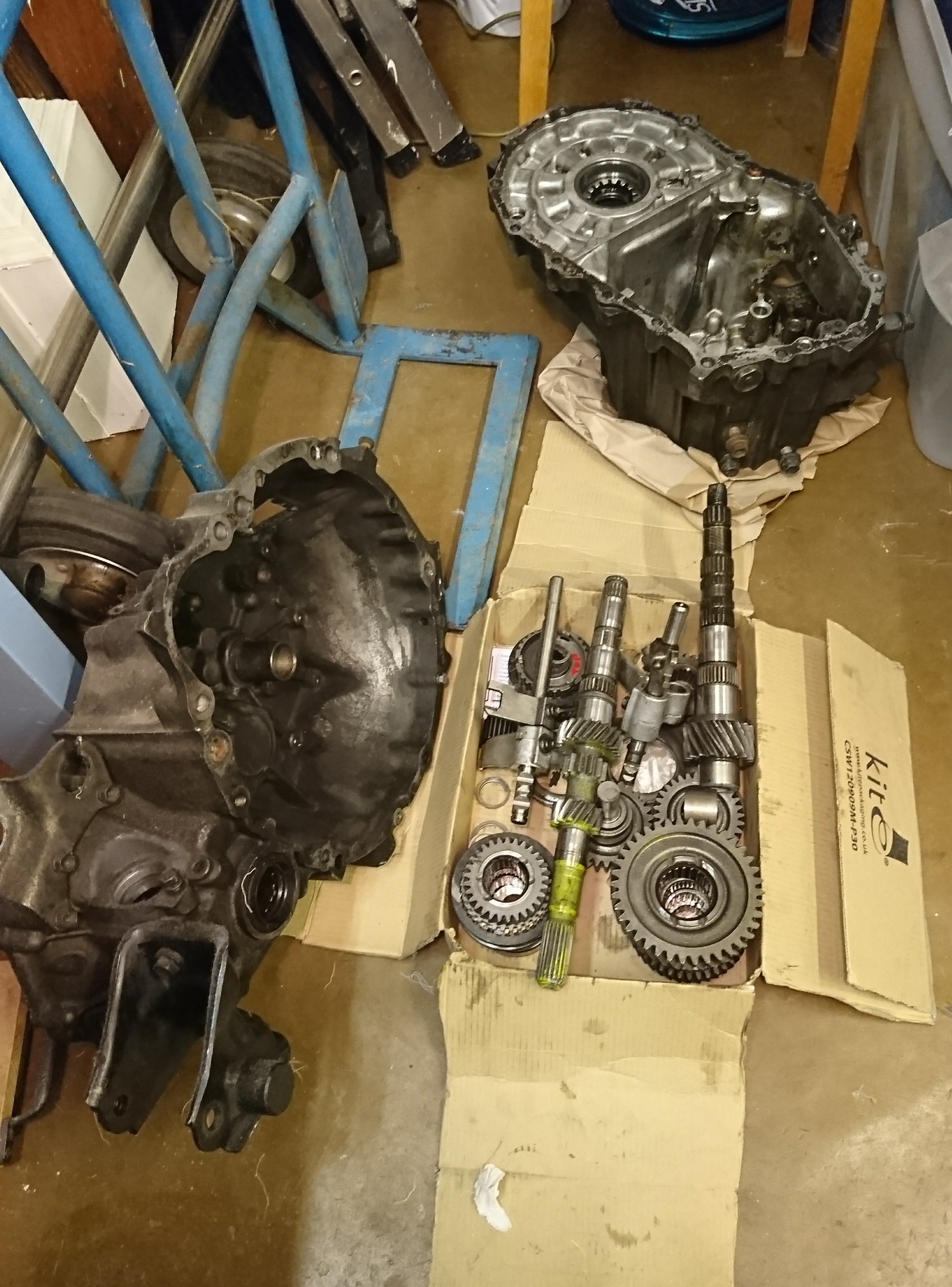

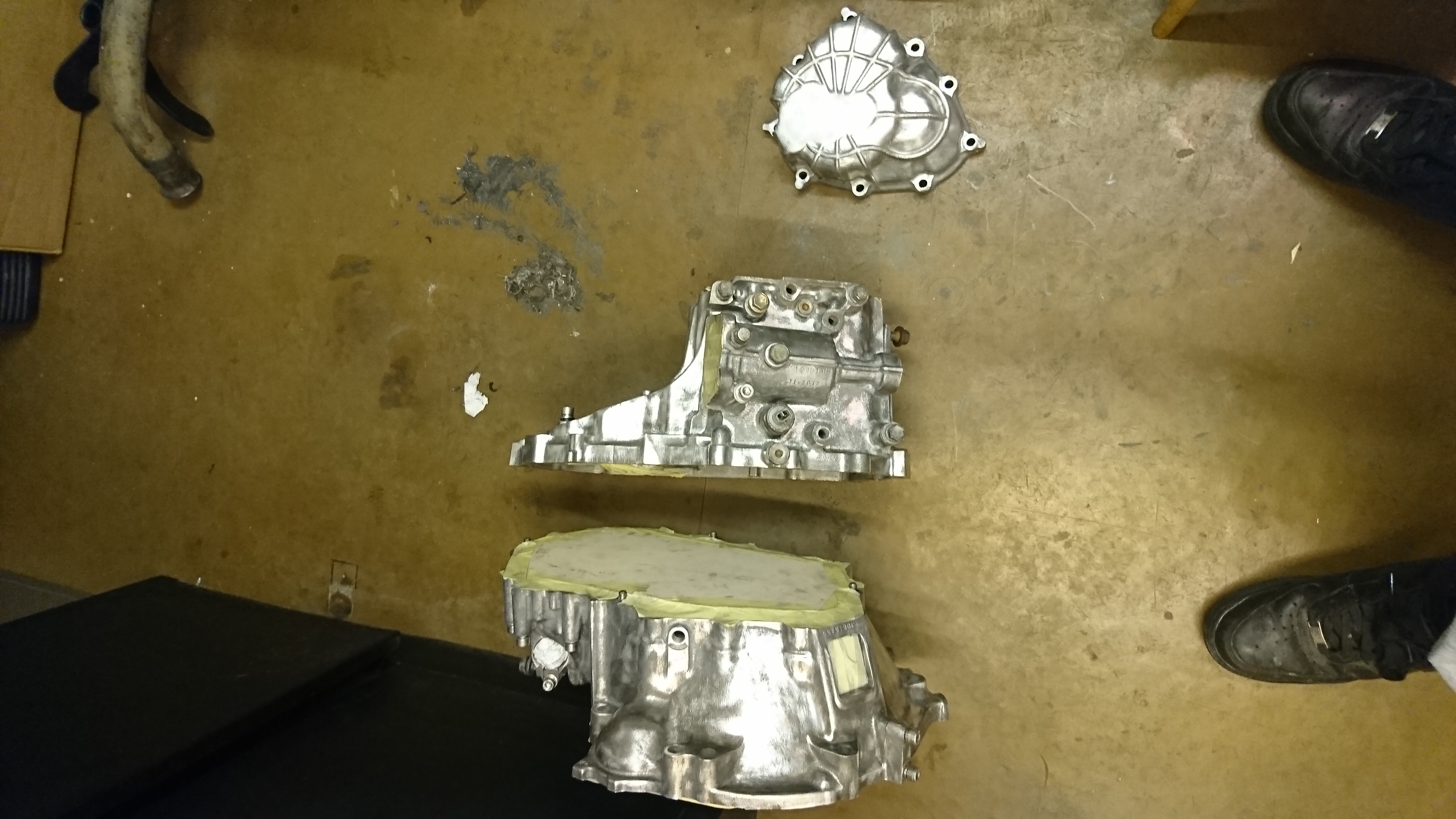

Now the cylinder head is done, I'm planning to tackle something much harder lol, along with the 5EFHE engine I had in my shed, I also had this C52 GT turbo gearbox that I picked up last Christmas eve. It's supposed to be fitted with a TRD LSD, but I don't know what type
So what I want to do is take it apart to see what type it is, if it's mechanical then fantastic! If it's a clutch type then I may have to think about keeping it or not, don't really want one requiring any special type of maintenance.
Then while it's apart I will inspect/check out the synchros and bearings, see what their like, maybe replace them,  but from what I understand, this would be a very expensive move.

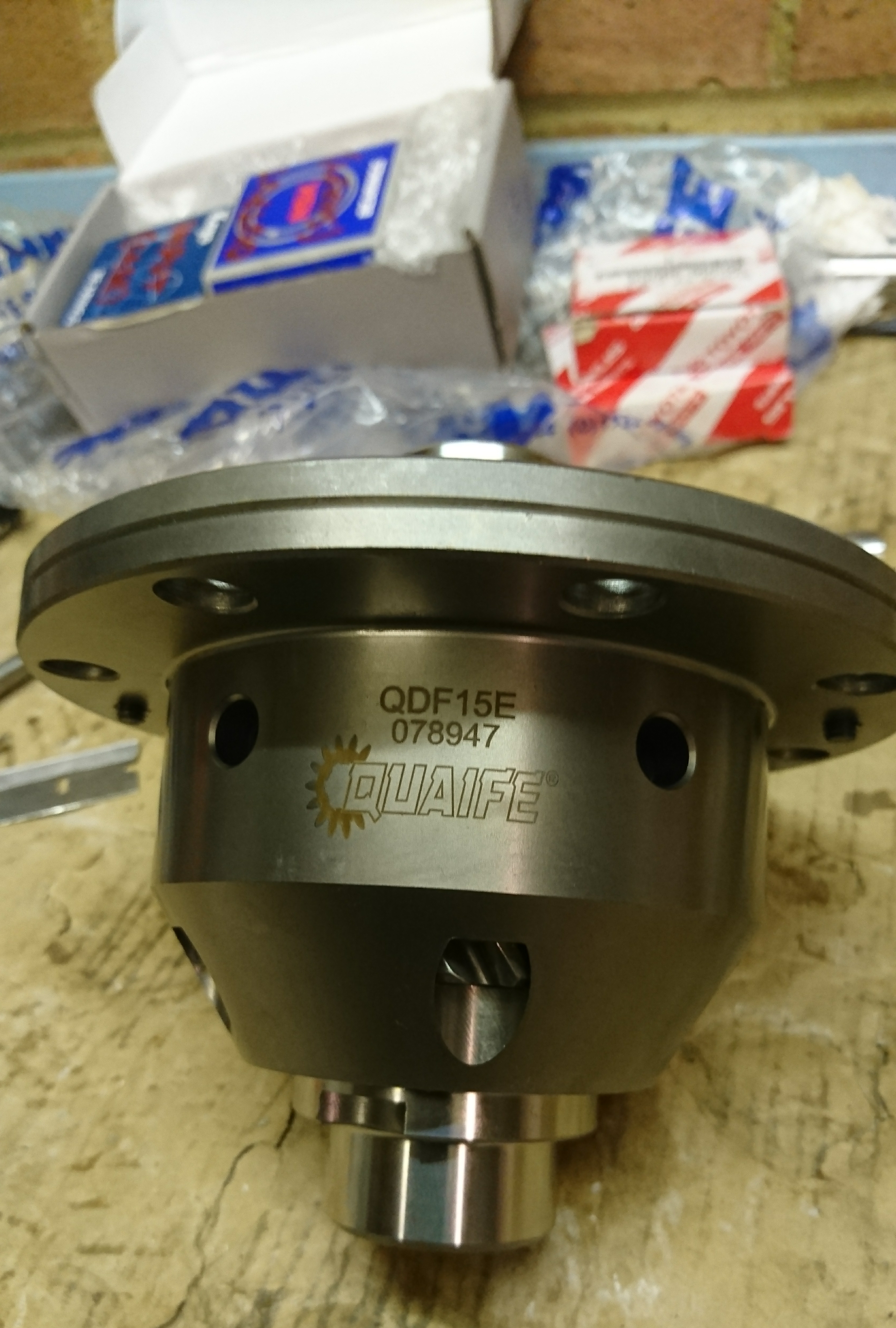

Got a package today
Inside was a Optional rubber boot mat that fits nicely and a TRD radiator cap
Lol I have actually bought 2 boot mats, a hard plastic one and the rubber one, haven't received the plastic one yet but now I got the rubber one I know the plastic one ain't gonna fit, as the rubber one is flexible to fit under my sub and over the spare alloy (which sits higher than usual)
So I guess once I get the plastic one it will be sold on, same with the TRD LSD
Got a estimate on all the gearbox parts and errm... Yeahh haha big bucks
but im sure I can get them cheaper elsewhere

Look what I got! :D
DSC_0322.thumb.jpg.b90b9a2324e6fa747b96e
Gearbox is now fully stripped and will start cleaning up the cases and a few other bits while I wait for the new gearbox parts
DSC_0320.thumb.jpg.b59379929b891ec8c5ee2

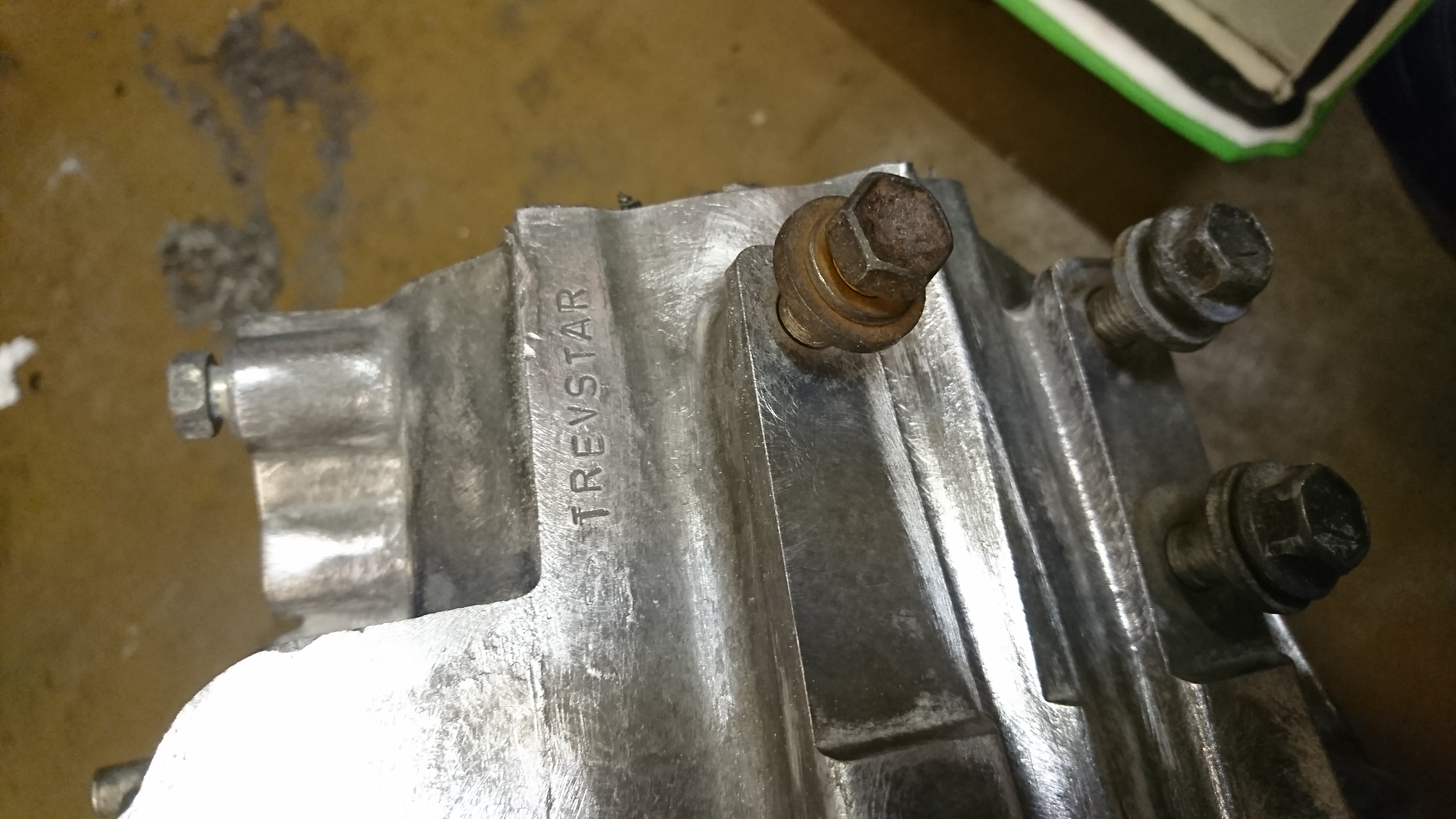

Wire wheeled the entire box, prepping for painting
DSC_0326.thumb.JPG.cb8a15365a20ef2aa4f5d

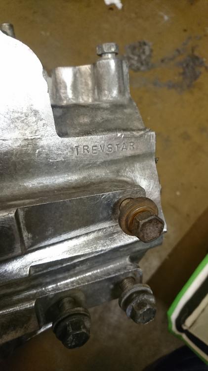

Stamped the rebuild date into it for future reference (yes I know it's a month ahead but I doubt it will actually be rebuilt til then anyway)
DSC_0324.thumb.JPG.2fe420df0510e33186fcf
And I placed my mark on it of course, like the cylinder head! Wasn't going to let my handy work go unnoticed :D
DSC_0325.thumb.JPG.7b05af659a1f33d70e836

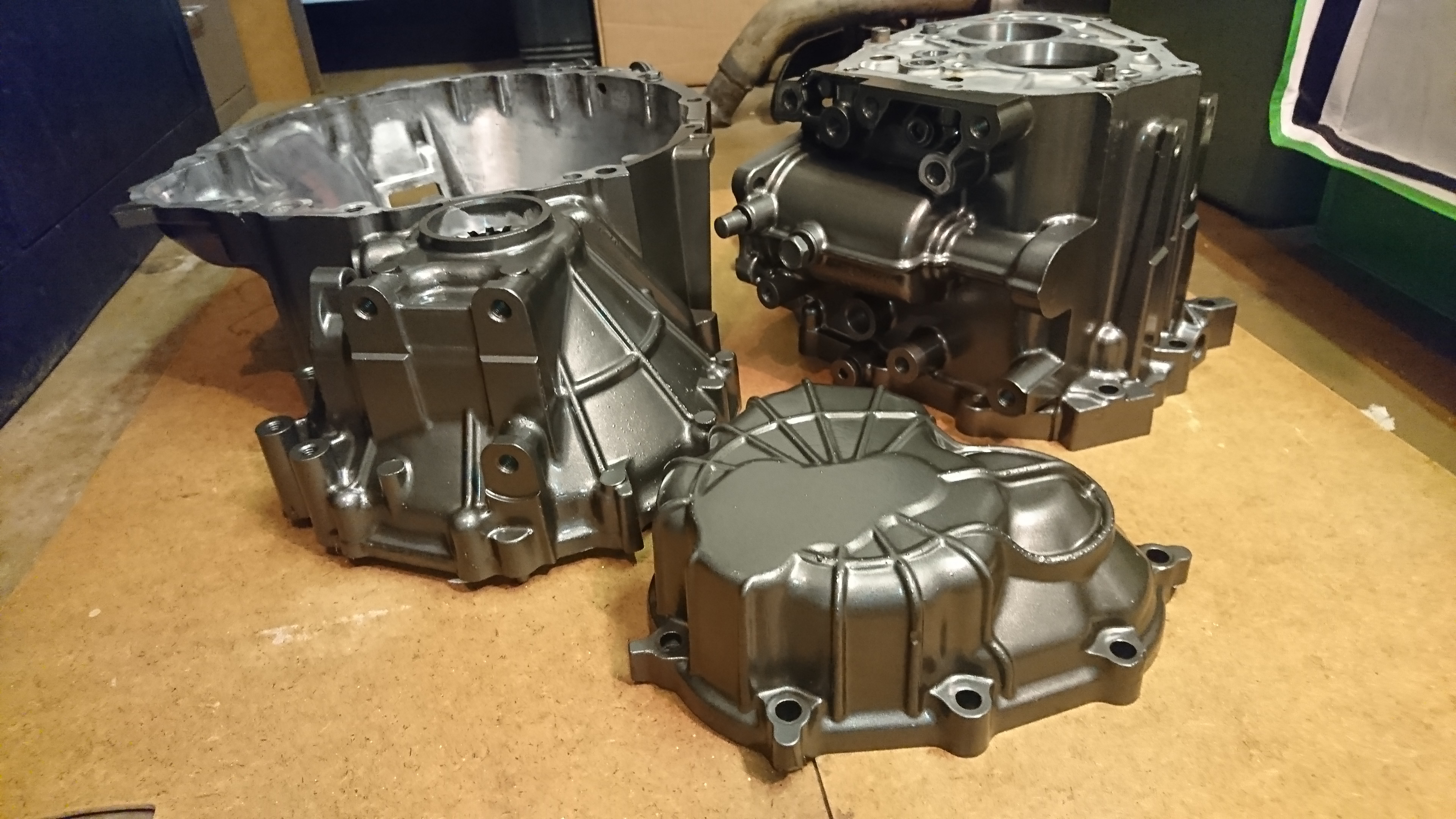

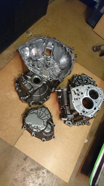

Gearbox etch primed, and painted with VHT SP997
DSC_0327.thumb.JPG.fa5a75af089c1d4891dce
DSC_0329.thumb.JPG.9aa064f524d5ce8647611
...To be continued...
