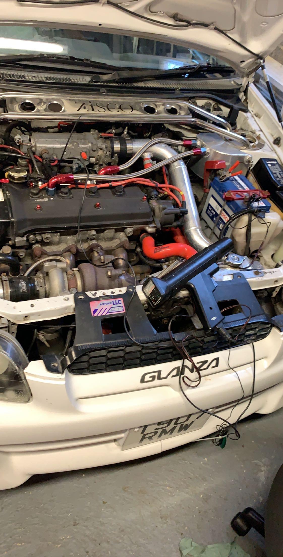

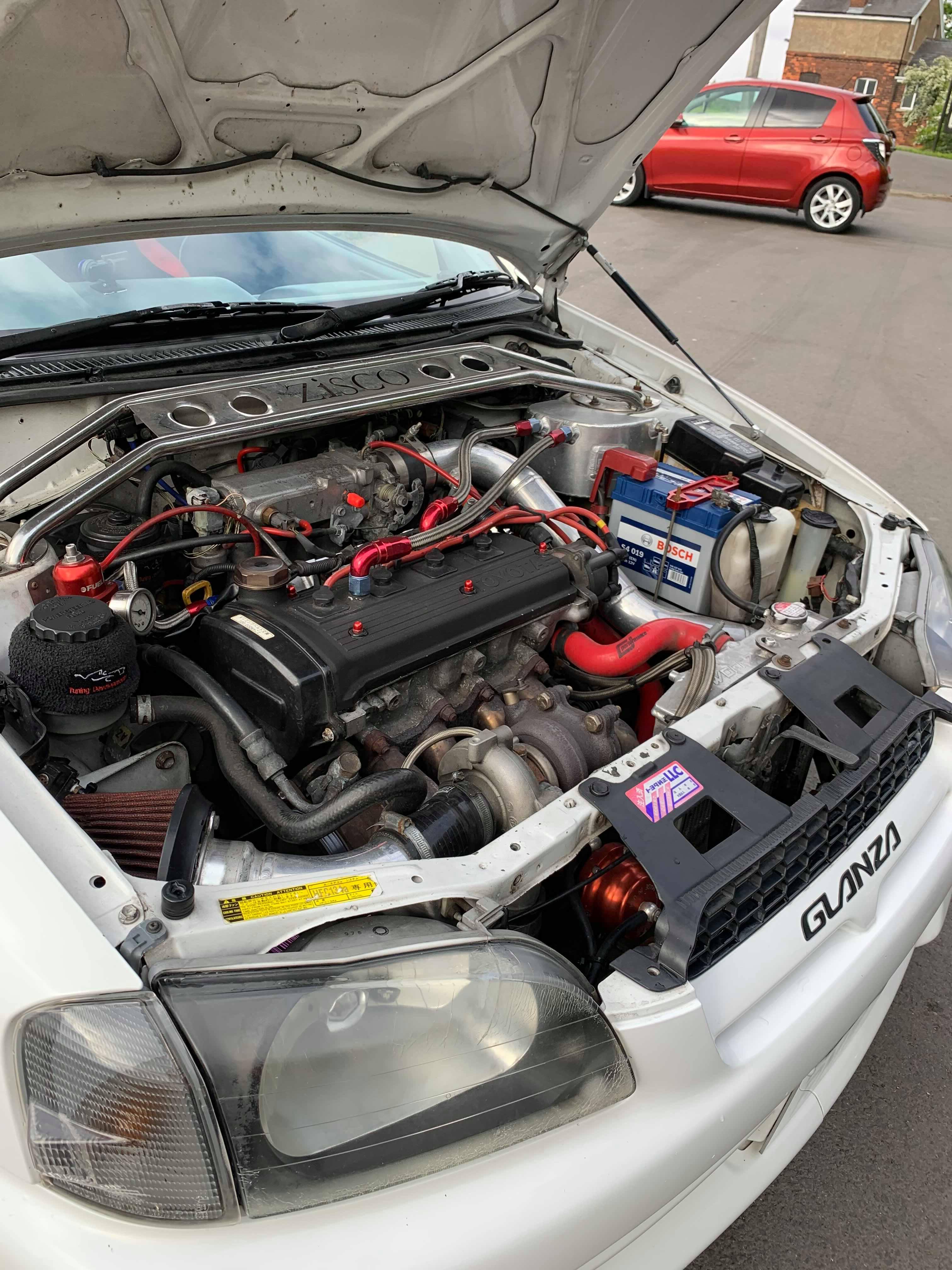

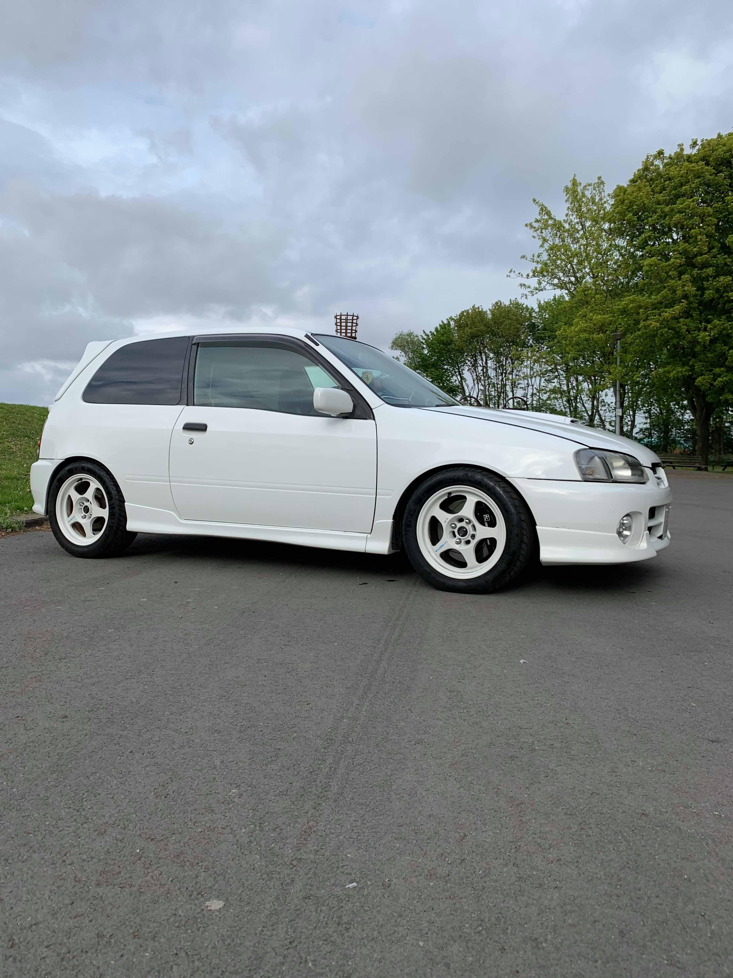

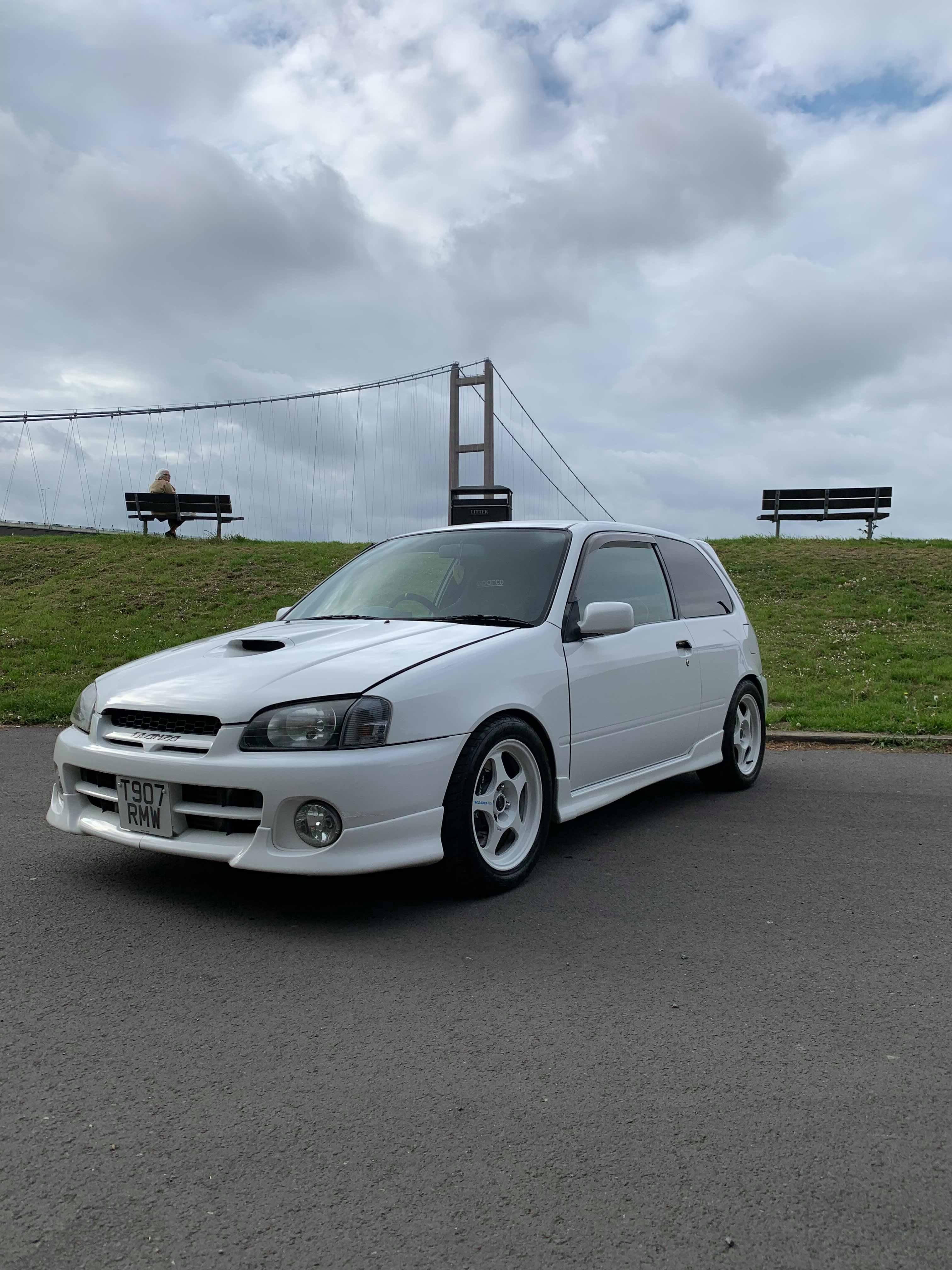

JxckGlanza Posted March 22, 2020 Share Posted March 22, 2020 (edited) Hello all, so I have bought my glanza back and decided to make a thread. The spec is as follows:- Engine and turbo Stock 4efte Spec 6 Puk stage 4 clutch Tuning development lightend flywheel RW Development top mount manifold with open screamer Tail External wastegate - 0.6 spring Tuning developmend TD04 - Hybrid billet Greddy ProFec OLED boost controller Apexi air filter and custom piping by RW Development RW Development full exhaust back system all v band ID workz half rad Front mount piping done by RW Development with toyosport intercooler rear exit RW Development catch can AN10 fitting A/C delete Fuelling and Engine Management TD fuel rail Braided lines FuelLab FPR Walbro 255HP fuel pump ME221 Gen 2 - A/W mapping K20 COP Bosch EV14 Redline variable TPS Syvecs IAT relocated to IC pipe Link 4 bar MAP sensor Innovate wideband MAC 3 port boost solenoid Brakes K sport 6 pot Hel braided brake lines EBC yellow Abs delete Suspension and handling BC coilovers Rota slipstreams Federal RS-R tyres Polybush mounts Interior Sony BT head unit 4inch Vibe Slick dash speakers Stock interior Cosmetic Zisco front strut OEM lip OEM Mid spoiler Kode battery holder H.I.D headlights Edited June 16, 2020 by JxckGlanza Quote Link to post Share on other sites

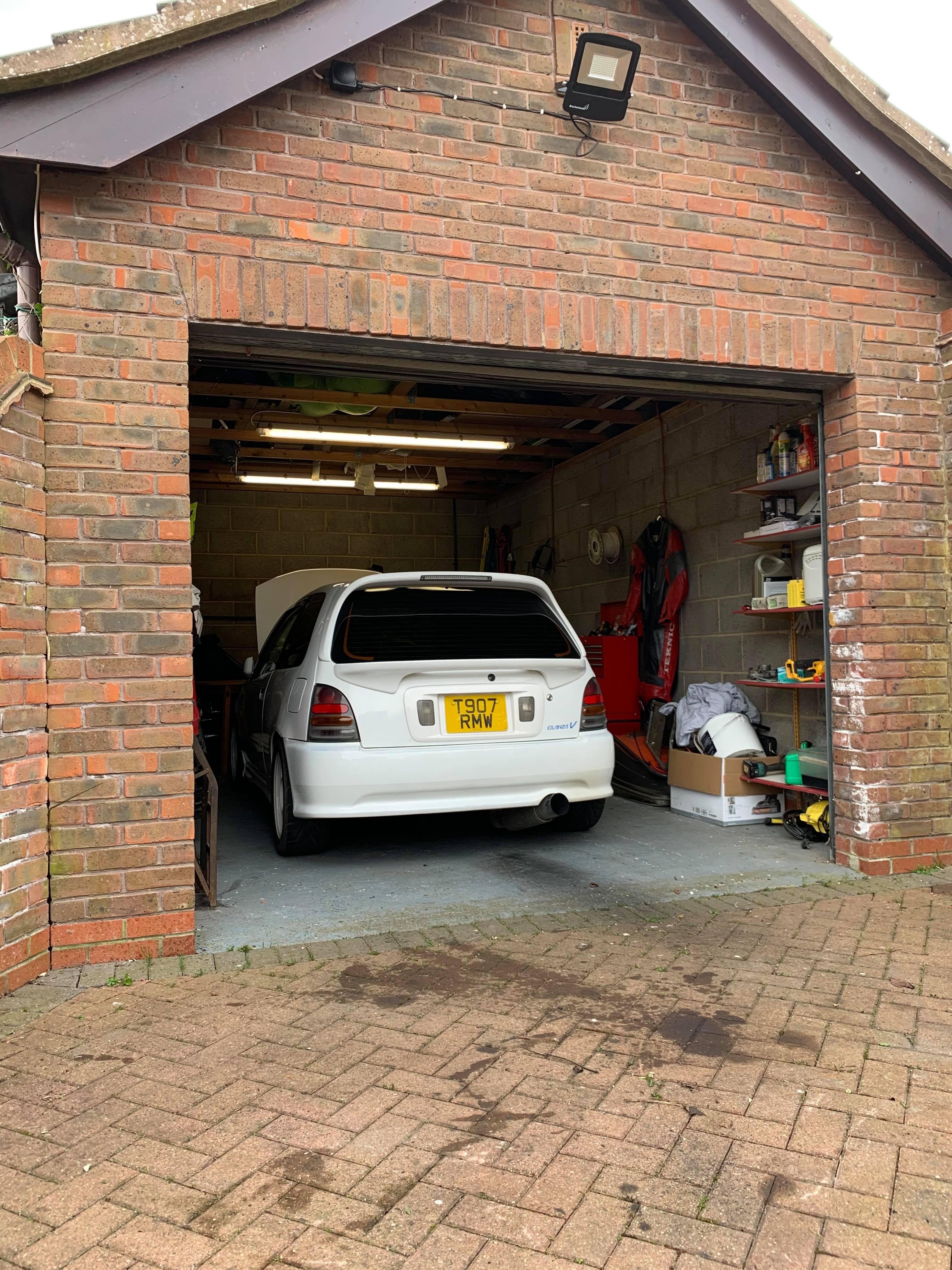

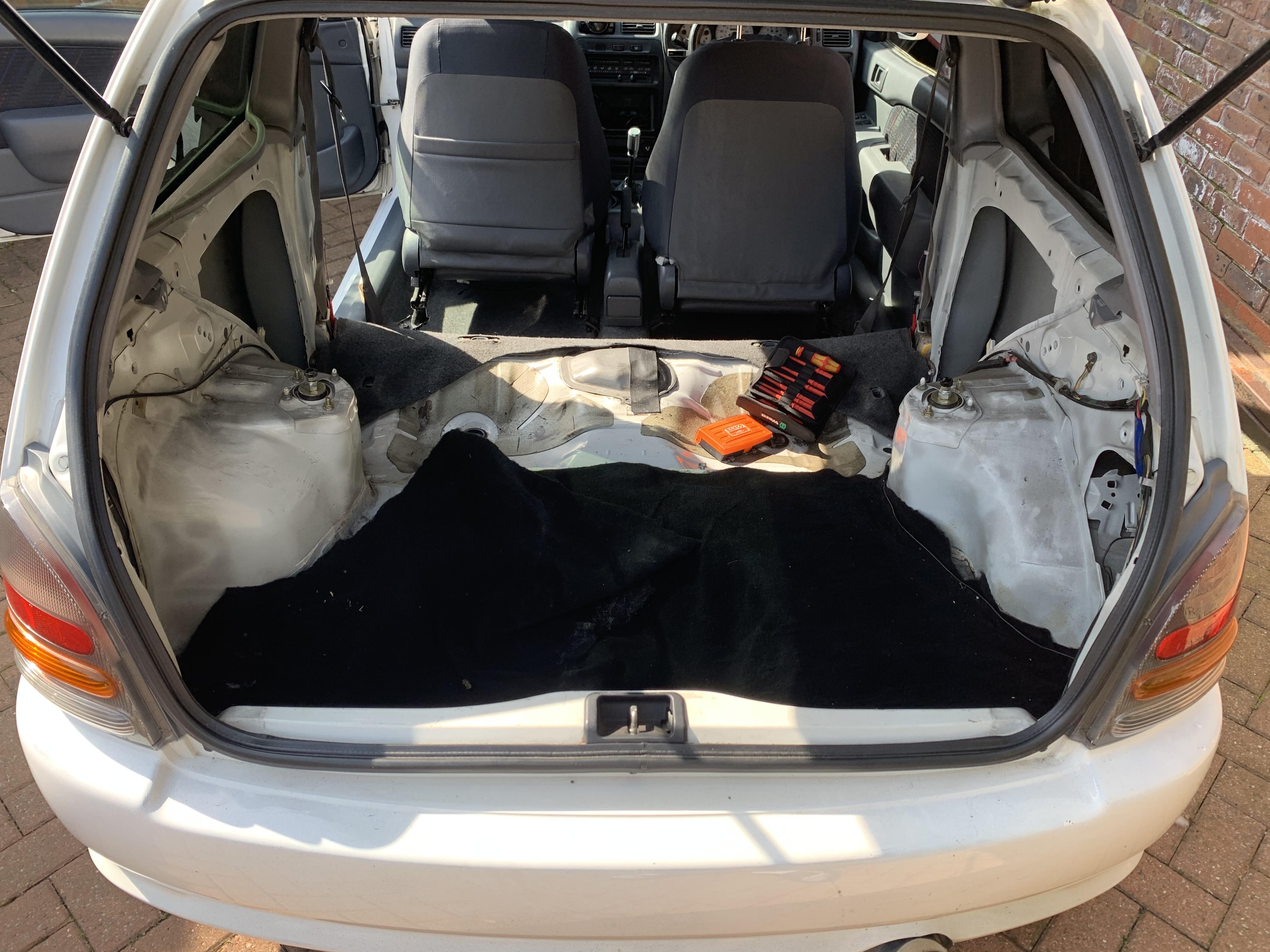

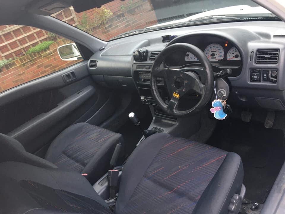

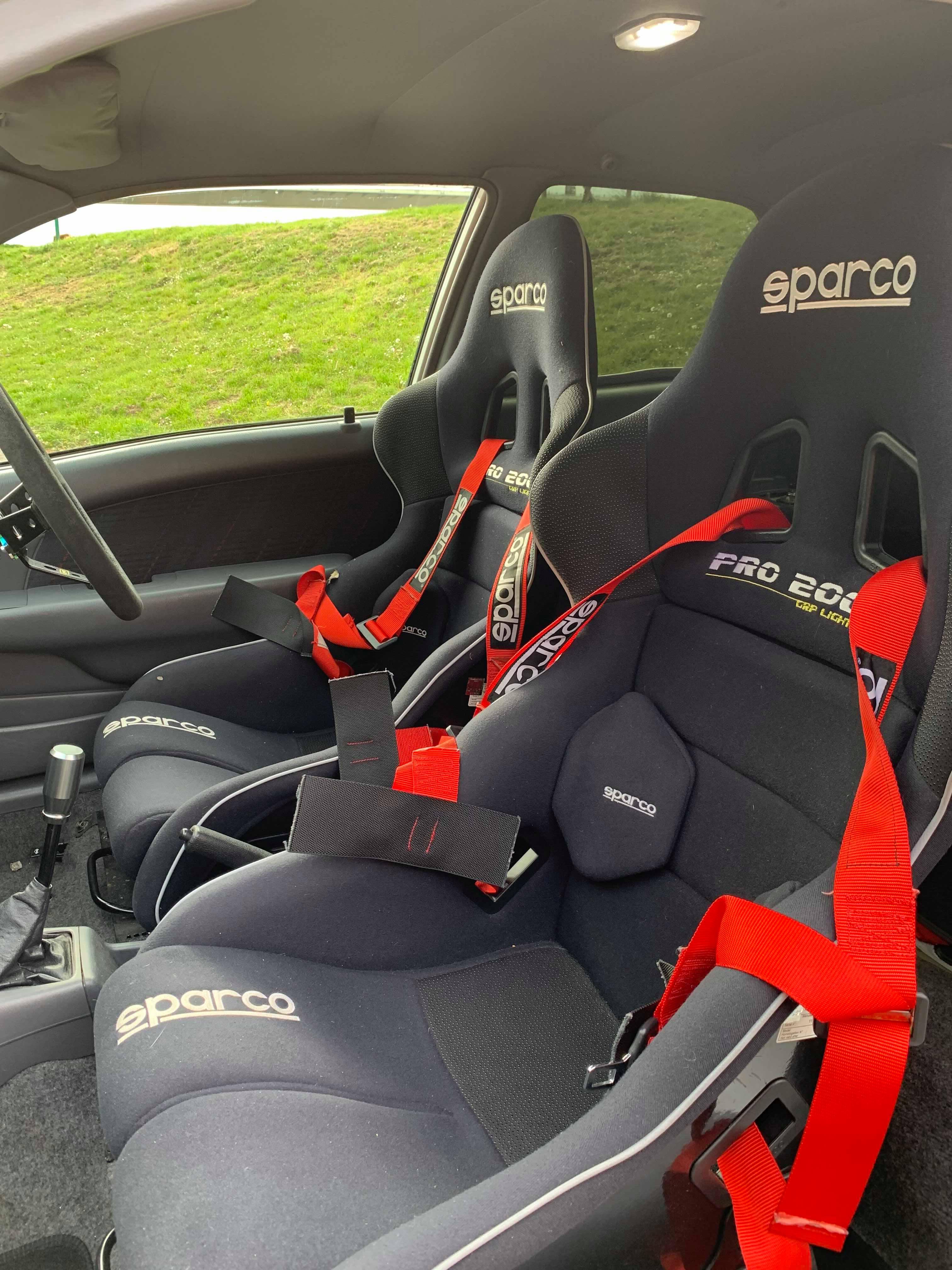

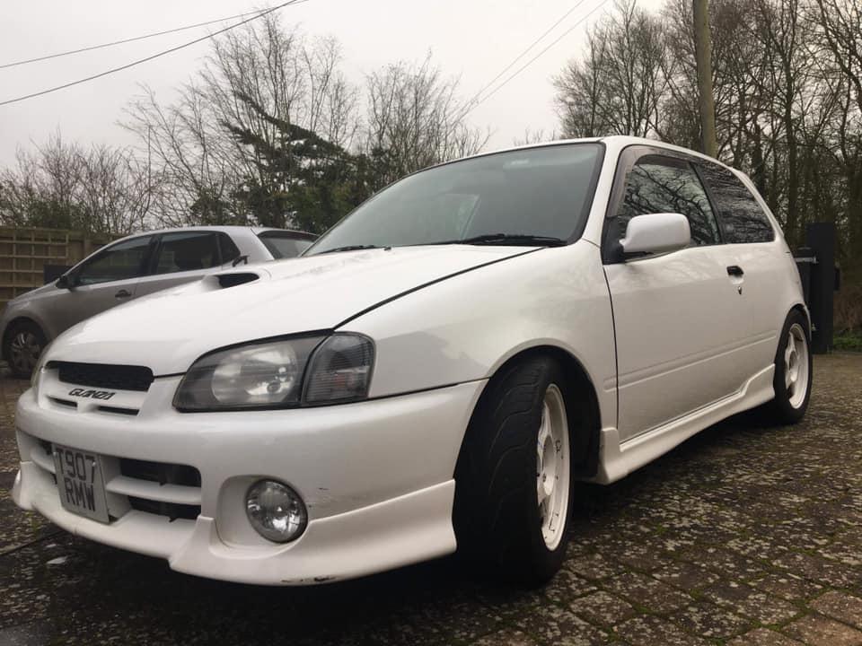

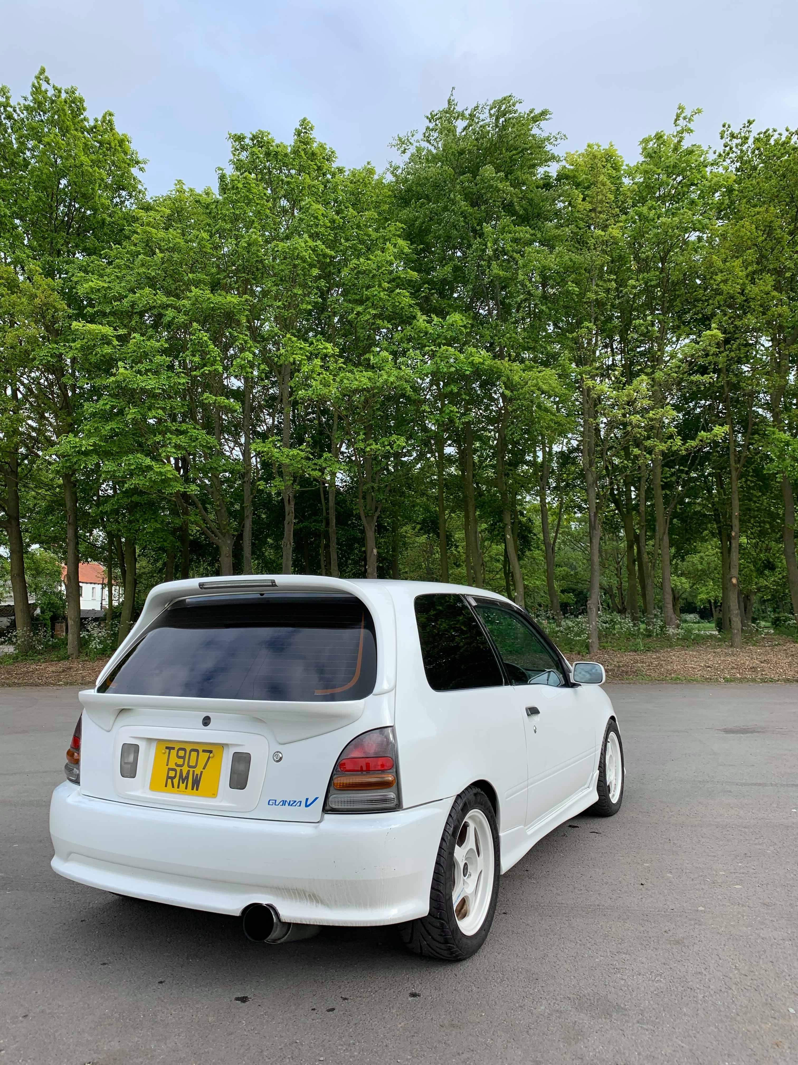

JxckGlanza Posted March 22, 2020 Author Share Posted March 22, 2020 (edited) Photos have been updated, that's how it was when i sold it, unfortunately its now stock inside, the guy i sold that car to was clueless and has left some things for me to sort and shape up. Here's some pictures of it inside and a dull side shot from the brain dead previous owner. Edited March 22, 2020 by JxckGlanza Quote Link to post Share on other sites
JxckGlanza Posted March 22, 2020 Author Share Posted March 22, 2020 (edited) So as it stands i now need to sort out:- the interior, some kind of bucket seats. I want recliners with normal belts this time though. some kind of speakers in the front, no stereo is draining. Remove the bov = flutterrrs fix the black soot from the exhaust - potential fuelling issue. Some glanza stickers under the window and a new indicator bulbs + bulb holder (old owner broke original one) the waxstat is now stuck open so it revs to 2k on idle. I’ve bought a second hand throttle body of Ian Parker also got a bulb holder off him which he threw in. (Massive thanks) Hopefully receive that mid week. the car seem to develop a pull to the left, I’ve looked into it and I think it’s tracking. I’m very suspicious previous owner hit a pot hole and knocked it off. As the camber was fully out on the car. I will get 4 wheel alignment. small petty jobs but I’m going to be a little busy for a bit. Edited March 22, 2020 by JxckGlanza Quote Link to post Share on other sites

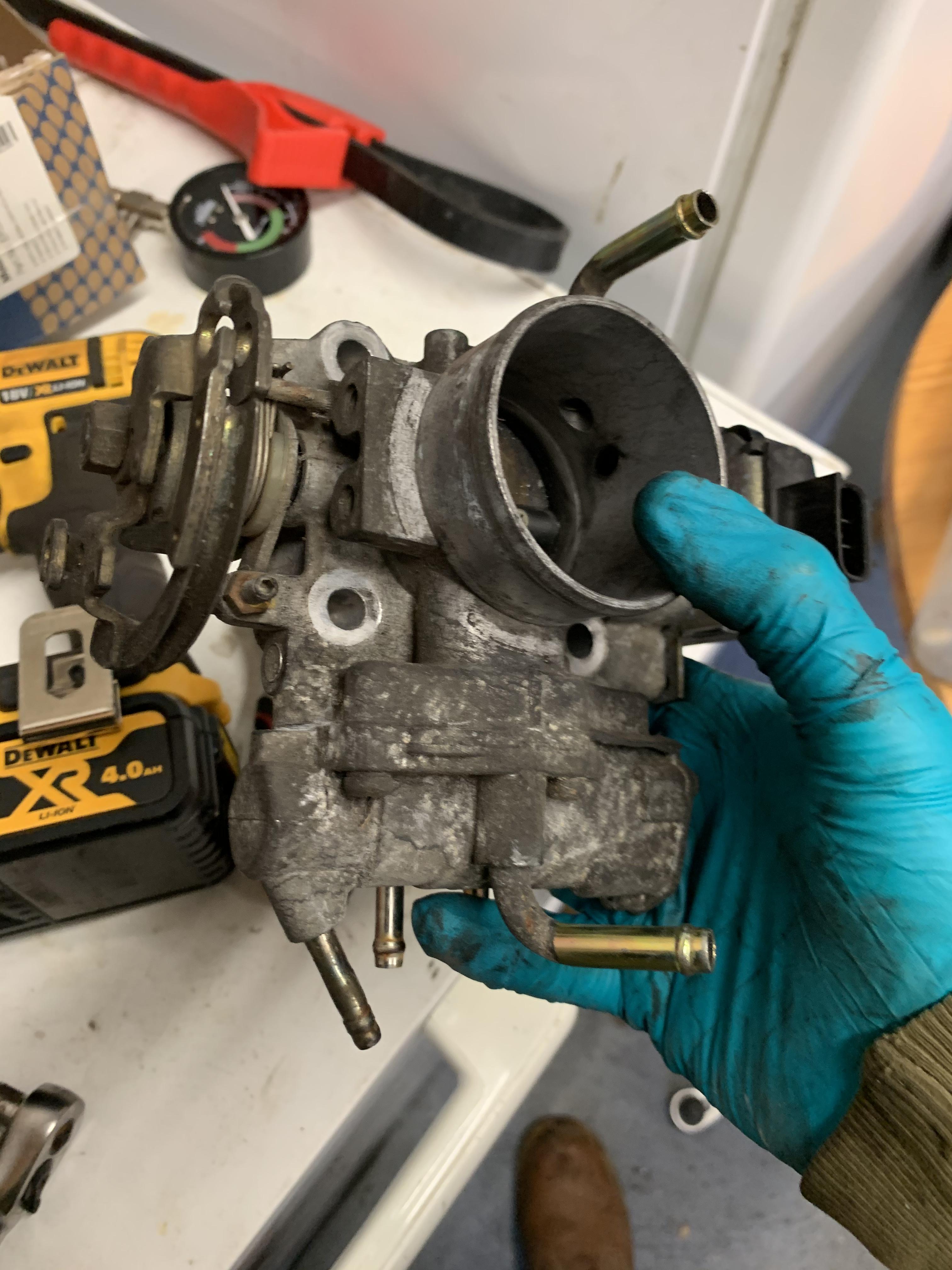

JxckGlanza Posted March 28, 2020 Author Share Posted March 28, 2020 (edited) Throttle body came and indicator bulb holder and been fitting she now idles fine. Can now actually start the car without going deff in 30 seconds. However the bulb holder was different type of bulbs. 😡 Took BOV off but no doubt it will go back on 😂 also ordered a coolant sensor I suspect that’s what causing it to run rich. can’t drive the car yet as my girlfriends corsa is on axle stands (sorting bits for MOT) but someone has messaged me saying it boost cuts in high boost. Not ideal another thing to the list. It did drive fine in low but soon as corsa done give it a quick drive. Found the strong smell of fuel from the braided hose , so will get that ordered , think will go with a ptfe hose to full prevent the fumes coming back! Edited March 29, 2020 by JxckGlanza Quote Link to post Share on other sites

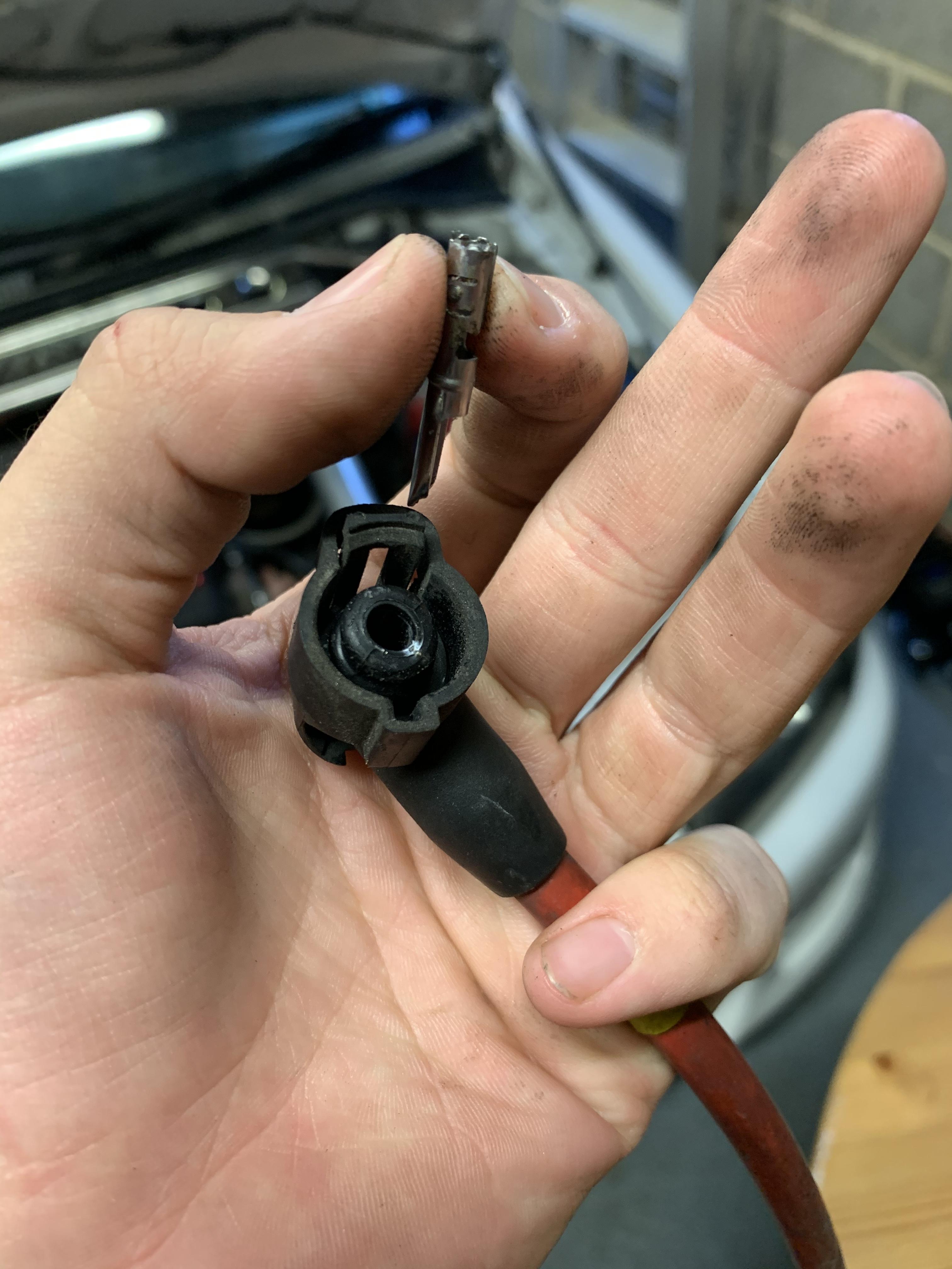

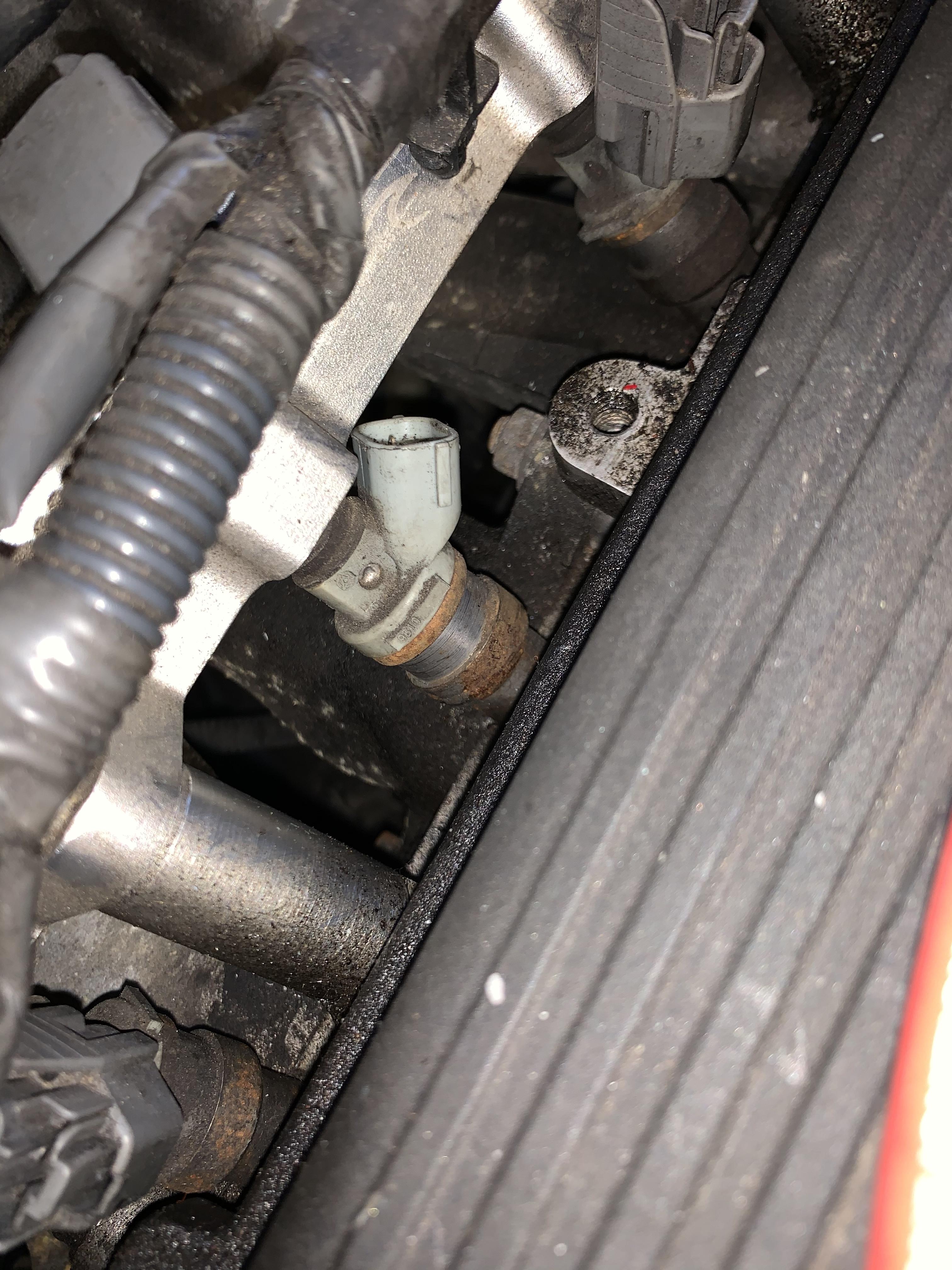

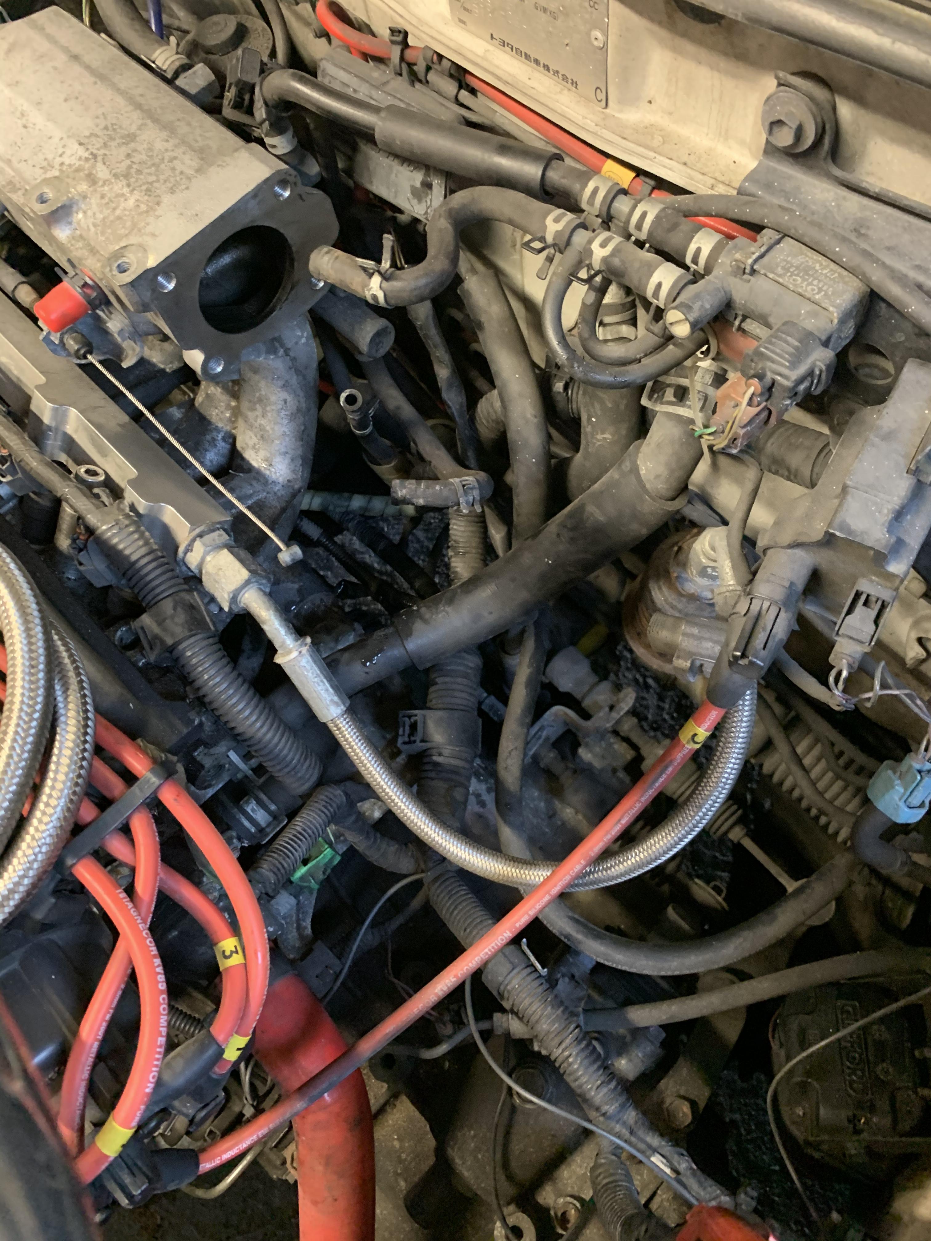

JxckGlanza Posted April 11, 2020 Author Share Posted April 11, 2020 Upon further inspect , found this believe to be the main culprit. Another thing ordered , I love glanzas 🤣🙂 Quote Link to post Share on other sites
BMX-RIG Posted April 11, 2020 Share Posted April 11, 2020 Ah an easy fix then! Funny how you ended up back with the car and having to fix its issues lol, looks as if your getting it back on track! 😎 Quote Link to post Share on other sites
JxckGlanza Posted April 11, 2020 Author Share Posted April 11, 2020 (edited) Stupid owners and neglect. These cars do require tlc all the time, end of the day they are bought to be drive hard. But yeah on with it mate,,,,cheers Edited April 11, 2020 by JxckGlanza Quote Link to post Share on other sites

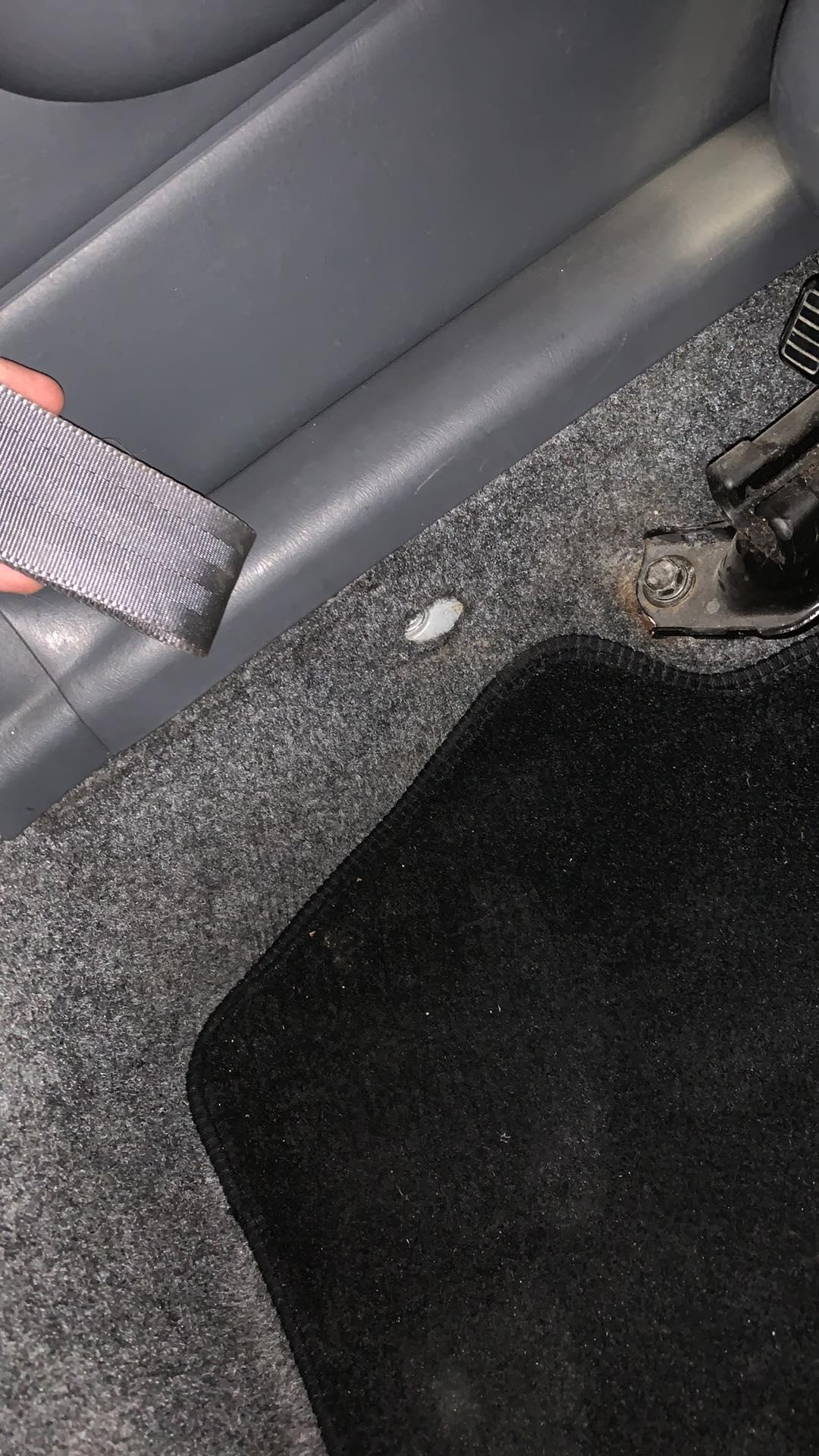

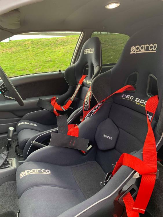

JxckGlanza Posted April 18, 2020 Author Share Posted April 18, 2020 Little bit of a update today, Ive managed to get some front seat belts, need to get some proper bolts, they are in but need some bolts for the upper seatbelt hanger for them to be perfect. Rear seat belts im still looking but the rear is stripped out. I put the king lead and new rotor arm on today and took her for a lap, I forgot how fast this thing is. Looking forward to getting the interior in and sorted, hopefully going to give it a go getting some 4 inch speakers in and a head unit I have in the garage lying about. will get a couple pics tomorrow Quote Link to post Share on other sites

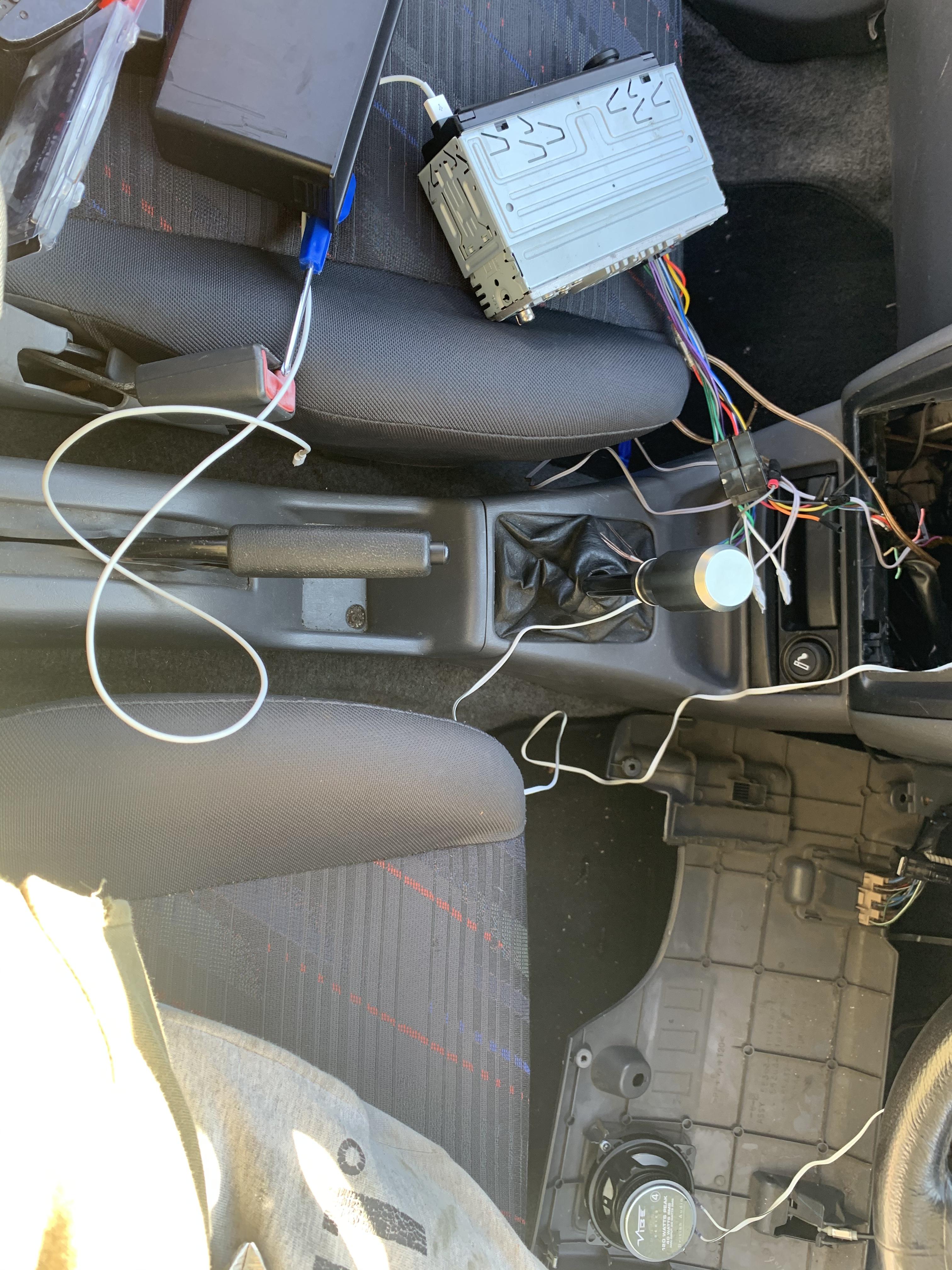

JxckGlanza Posted April 20, 2020 Author Share Posted April 20, 2020 (edited) So as the car stands , I’ve checked the ignition timing and the engine timing. Perfect, it’s left the injectors and emb, the afr is contantly reading 11 on idle. Rather rich. Piggybacks are awful and it was fitted and mapped probably 5yrs ago and it was old tech then. so I have ordered a ME221. I’m going upgrade the (which I believe is stock) injectors. I got the headunit and 4inch dash speakers fitted , some sound in the car which I am more then greatful for. It’s a start and the 4 inch are better then I thought to be honest. Once the interiors is in I might look at fitting some 6x9 or a custom door car either way it takes the drone away. ive found some rear belts and ordered them. So leaving the rear interior out until i fit them. Exciting times ahead Edited April 20, 2020 by JxckGlanza Quote Link to post Share on other sites

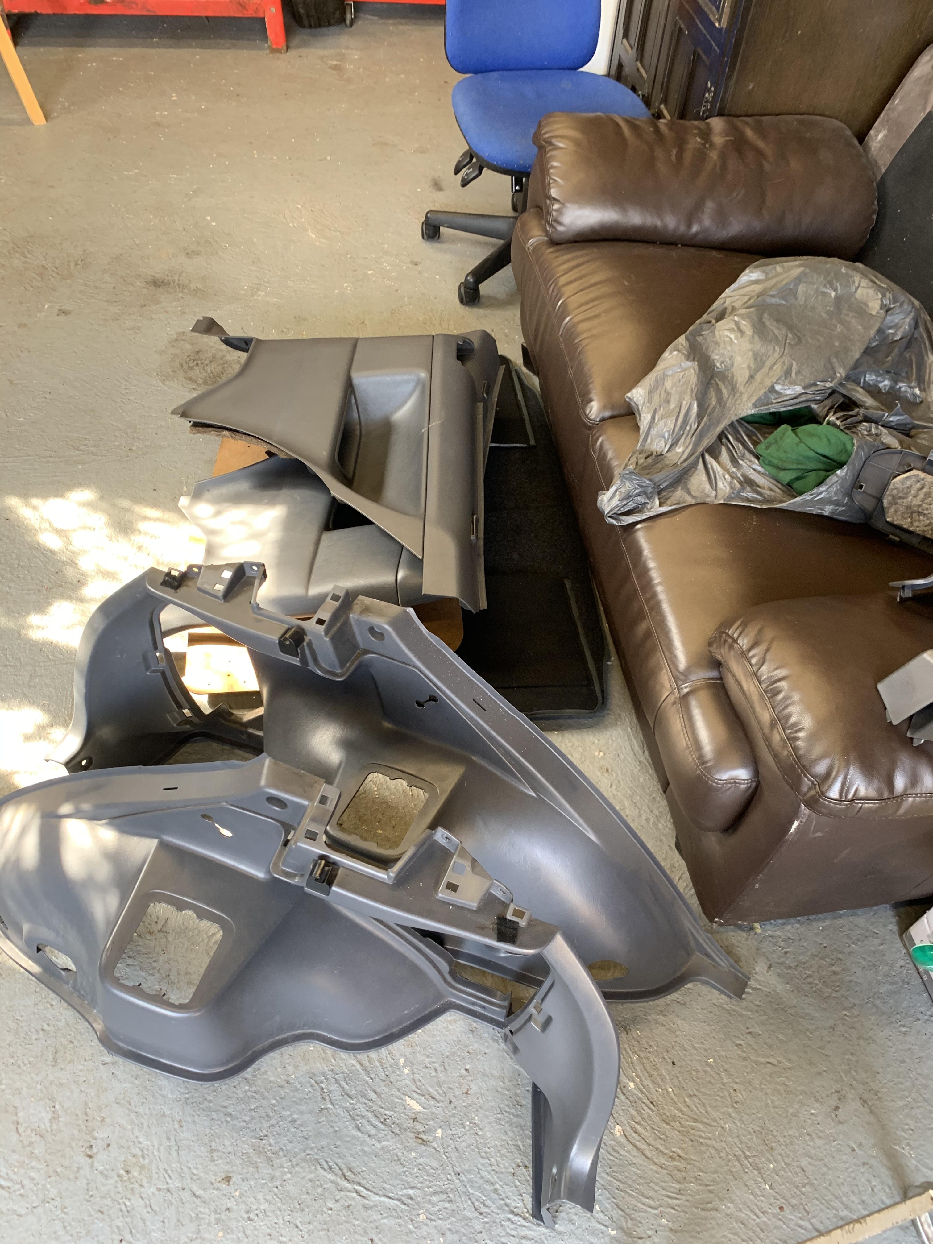

JxckGlanza Posted April 22, 2020 Author Share Posted April 22, 2020 On 4/20/2020 at 8:19 PM, Gav Missen said: Liking the build mate another white one 🙌 you should have looked on my thread man I stripped it out yesterday and won’t be using any of the belts you could have had what you wanted there only going to lay about! Hi mate, thanks. Shocker, that frustrating. I tried messaging you on Facebook, never heard back off ya. Quote Link to post Share on other sites
